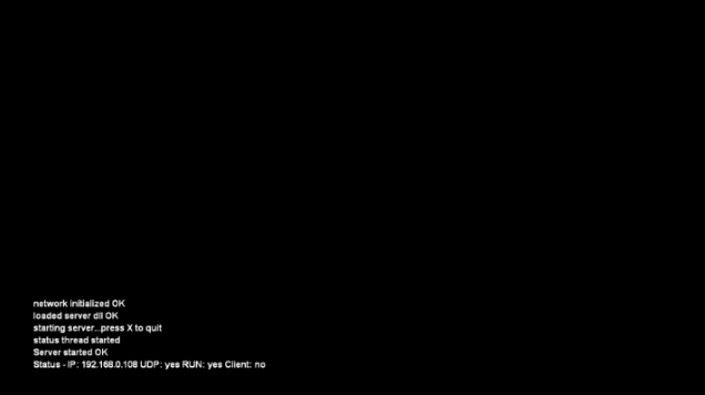

    You must be running updsvr_standalone_v1 on your console for this GUI and xebuild to connect and perform maintenance on your console.
    Setting up updsvr
    1. Extract the updsvr_standalone_v1.zip to a folder and transfer the default.xex to the root of a usb drive.
    2. Plug the usb drive into your console and power it up. You should now see updsvr on your console.
    If you are experiencing connectivity issues with updsvr standalone v1 please try running the built in updserv from within Dashlaunch or at last option try updsvr standalone v3.
