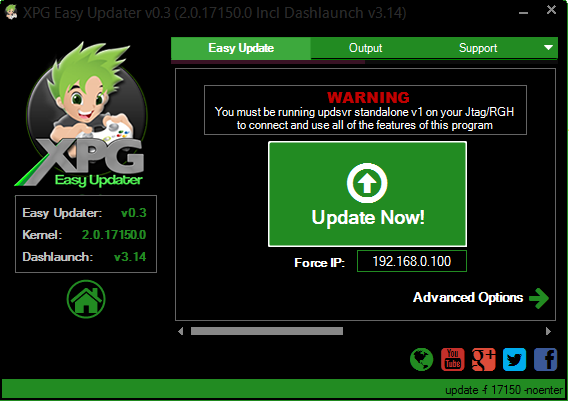

    (Pictures from last version, is exactly the same but updated)

    Easy Update
    1. Open the XPGUpdater.exe and click the Update Now! button.
    Yes it is really that simple to update your console.
    Once the console powers down after flashing remove the usb drive and it will now load into your dashboard set within your launch.ini
    If you have any issues connecting to your console try using the Force IP option.
