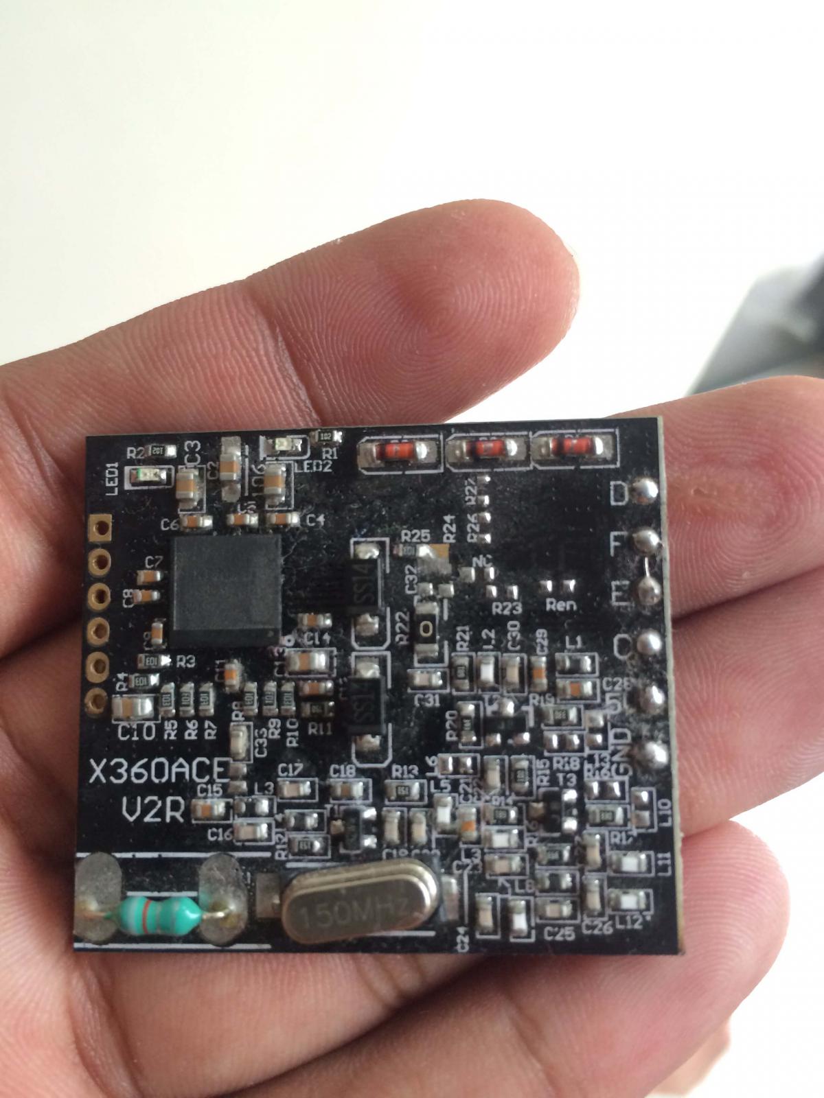

    OK it was succesful. They gave me a a motherboard piece, and said that they have replaced it. I dont know what the heck that is. Any ideas....?
    So can i update the Dashboard to 17489?

    They guy who fixed it forgot to update it to 17489, hence when i tried using the XPG updater. The same thing happened all over again. So the xbox doesnt work again. why does this only happens to my sorry arse. So what am i doing wrong??

    Not sure why it keeps bricking your console but the glitch chip you have inside is not the best to be fair.
    I would take it out and fit Team Xecuter products, Then you will have a site full of support and good quality stuff.
    X360ace are not the best at all sorry to say.

    Sep 29, 2015
    will try the Team Xecuter glitch chip and upfate on the results. Thanks.
