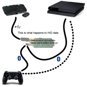

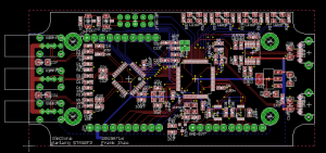

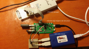

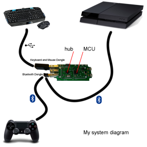

    I designed a circuit that features a microcontroller and USB hub. The keyboard and mouse plugs into the USB hub, and then the microcontroller takes the data from the keyboard and mouse, translates them to the data format used by the PlayStation 4. It does the translation in a way as though the mouse was the right thumbstick, and the keys are mapped to buttons (the WASD keys are mapped to the left thumbstick).
