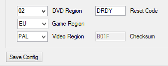

    Open up your nand in J-Runner and go to "SMC Config Editor"
    Look for your "Reset Code"
    On your Xbox 360 go to settings then System Info.
    On the System Info page press the buttons below followed by your reset code:
    LEFT TRIGGER, RIGHT TRIGGER, X, Y, LEFT BUMPER, RIGHT BUMPER
    *So mine would have been LT, RT, X, Y, LB, RB, Down, Right, Down, Y.
    Nice and simple, I've had 2 of these now and thought I'd share for future reference.
