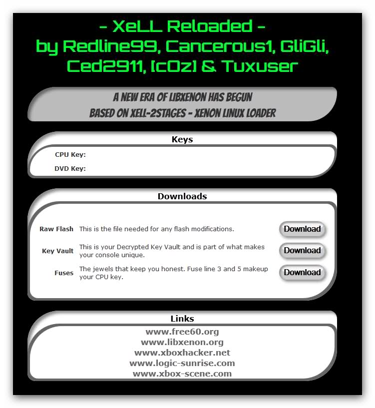

    Dumping your nand over the network is slow - you should only do this if for some reason none of the other methods work for you. For this to work you need to boot up Xell with a network cable plugged in (wifi will NOT work). When Xell is fully booted it will display an IP address towards the bottom that will be 192.168.X.X (the X's will be unique to your network).
    Simply take that IP address and type it into a web browser on a computer attached to the same network. You should get a page that looks like this:
    Simply click the button to download your "raw flash" and name the file nanddump.bin and save it. This will take quite a while, and you have to leave your Xbox on and running Xell the whole time.
    You should be able to boot Xell by pressing the eject button with your console off to boot Xell and your CPU key will be displayed to you. Alternatively you should have it in a CPUkey.txt if you were provided with a backup of your nand files.

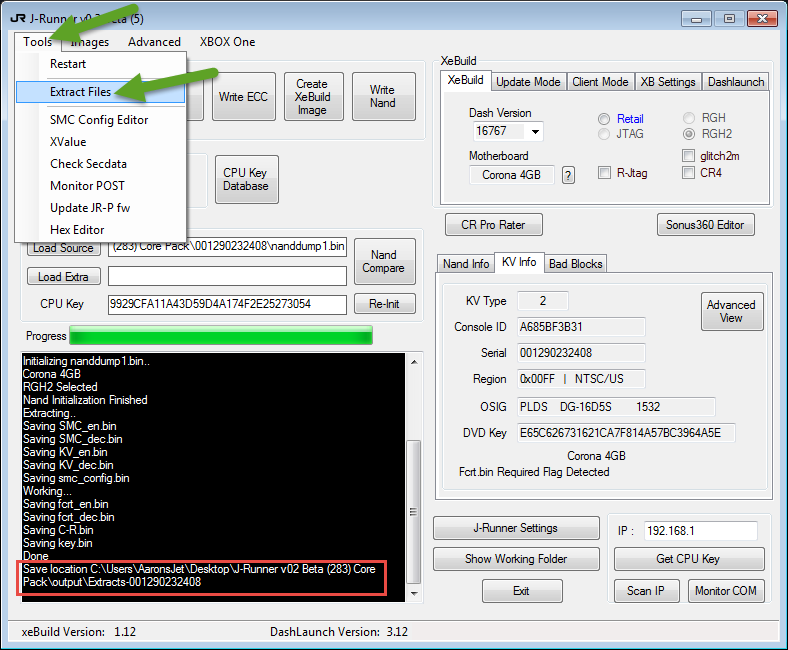

    In order to do this open up Jrunner and load your "nanddump1.bin" or "flashdmp.bin" file as Source. Then you'll need to put in your CPU key. You'll know that it's correct as long as the CPU key successfully decrypts the nand and reveals the info under the "KV Info" tab. If that info is missing/not populating then STOP!
    Now simply click the Tools -> Extract Files Option. Make special note of the "Save location" that gets indicated in the output window
    If you browse to that location on your computer you should find these files:

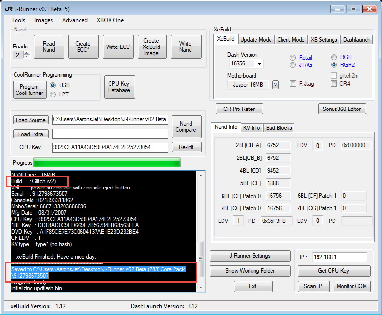

    At this point you probably still have Jrunner open on a blank window with nothing loaded, if not just fire Jrunner back up and make sure that there is nothing loaded in source or extra. Paste your CPU key into the CPU key are, and make sure that you have the appropriate type of hack selected in the upper right (JTAG,RGH1,RGH2)
    Now simply click the "Advanced" then "create image without nanddump.bin" once again, this time since we've placed the files we won't get the error, but we'll get a popup asking us to "Choose LDV"
    LDV only matters on retail consoles, and retail consoles can't run replacement KVs so you can enter whatever you want. Just stick to "1", it doesn't really matter.
    You'll then be prompted for your console type, which is pretty easy - just pick the one that matches your console.
    You should then see the log go to town creating your new image.
    NOTE You will see this error in the log:
    ******* WARNING: could not verify pre-decrypted keyvault, please be sure your provided a valid kv.bin!
    This is completely normal! It's because the KV is different from the original.
    You should note in the log output that the "Build" should say the type of hack that you are using. If RGH1 it should say just "Glitch" if RGH2 it should say "Glitch (v2)" and so on. Make sure you double check this.
    Finally, in the log it will tell you where it wrote the newly created image, generally to the folder of the serial number of the console from the new KV, so just browse to that folder to find the new updflash.bin
    And that's it! That newly created "updflash.bin" is the new KV with your CPU key and config files and is ready to be flashed to your console. Flash it with whatever method suits your fancy. (Xell, Nand Flasher 360, Simple Nand Flasher, or even hardware flash it).

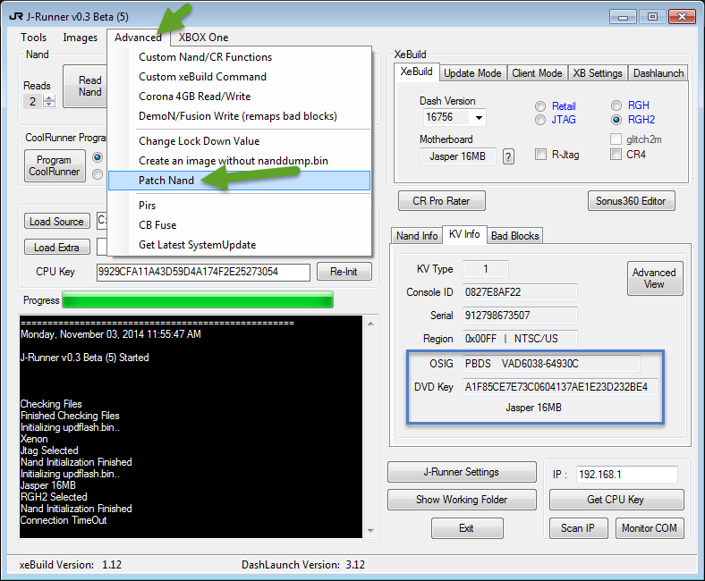

    Optional Step: Making your DVD drive work with the new nand!
    If you followed the guide above exactly, you'll notice that your DVD drive information in the KV section of the newly created updflash.bin is actually that of the console that the new KV came out of, not of your original. Because of this if you flash that image "as is" the DVD drive will not work - you'll simply get the "Play DVD" option at the dashboard.
    If you want to fix that, it's very simple. Just load up the newly created "updflash.bin" file as source and paste in your CPU key if it doesn't populate automatically - then select "Advacned" then "Patch Nand"
    In the dialog that appears, simply paste in your original DVD key, and select the proper OSIG that matches with your original nand (if you don't have these values saved somewhere you can load up your original nanddump.bin and save them).
    Finally just make note of the log where it outputs the location of the new "updflash_patched.bin" file. You can rename it back to just plain old "updflash.bin" if you are going to flash it will Xell.
