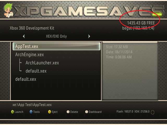

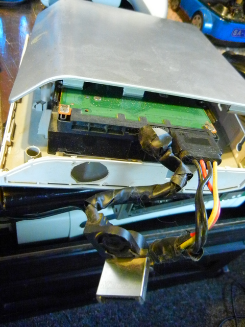

    I know this is slightly off topic from what you are asking, but I thought I'd share it as it is a way to use an "external drive" a bit more effectively as an "internal drive"
    mine is done similar to this tutorial,, http://www.xpgamesaves.com/topic/42041-35-hard-drive-motherboard-mod-tutorial/
    however I keep mine in it's original case, and use external 5v & 12v power supplys (wires to power supply boxes can be seen in pic below) because I don't like the idea of sucking power off the mobo.
    as you can see I have 2tb internal
    and here is the wire setup I use (the data half of the MS HDD connector, and a sata-molex cable running to a 5v, and a 12v power supply box

    That is very useful thanks begal i do wonder if a novice like me would be able to do that though lol oh well guess theirs nothing to do but try :p
  20. begallegal1
    Oct 31, 2011
    3,694
    3,132
    In a Field of Green
    Yea man, a $3 sata-molex connector, and an old MS hdd cable will get you there in various ways, most people just pull power of the mobo like in that tut,,but I don't like to do that , so I use 2 power supply boxes (5v,12v) from old drives or household electronics. I've had that setup using that old seagate drive for a couple years with no issues ;)
