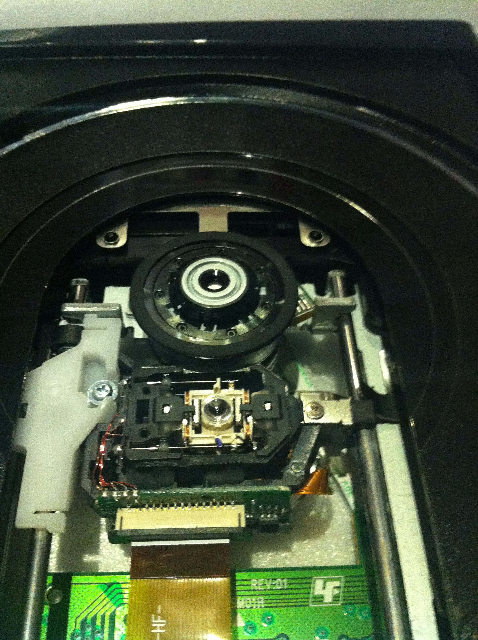

    can someone post a pic of what ribbons i disconnect before drilling plz

    [​IMG]the big brown one running to the laser unplug the ribbon on both ends and put it in a safe place while doing th flash
