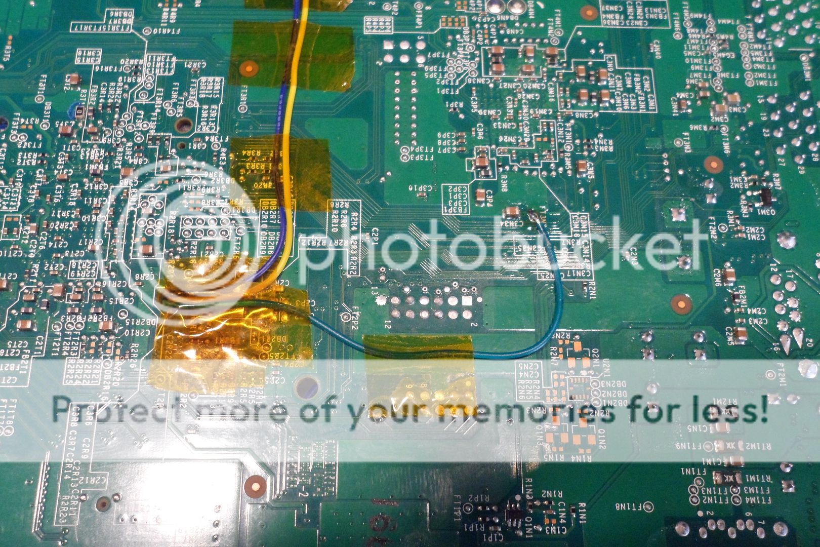

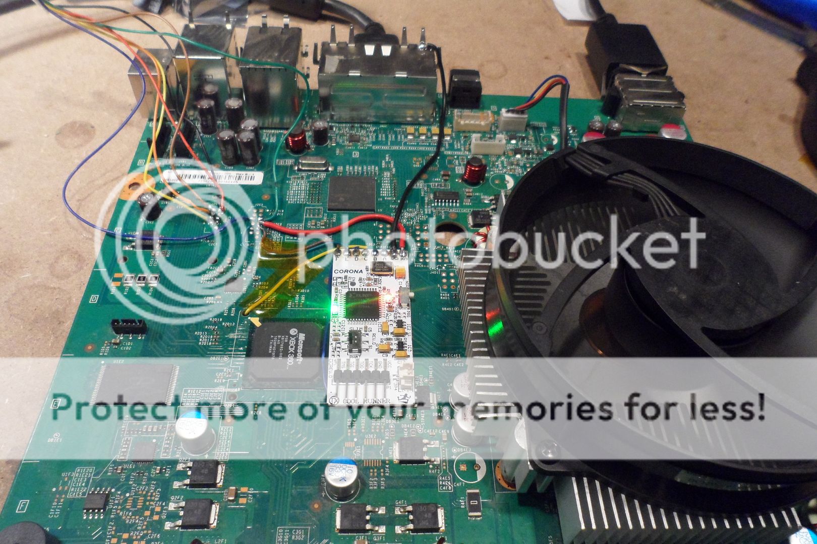

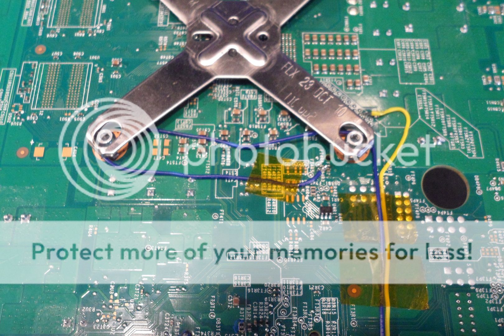

    Ok as promised here ya go. This is done on a trinity I also Did a Corona As well will post that up too.
    Tx (uses the same xlink chip that is on here for all their products. at twice the price if not more. Its a Joke.
    This little beauty is 7 bucks on amazon and works just as good If not better So Here you go
    Wire Just as you would a coolrunner Rev.C The d is only because they put the clock on it for corona
    revision level.
    Here is where i removed the Jumper on the board and used the clock on the Trinity MB
    Nice and Neat Notice the Standby clk Instead of the Rb Pad On top side easier to solder to the ft3n2 Bottom side of the board.
    works much better
    No need for the excess super long wire. Just a simple Route around worked on this trinity.
