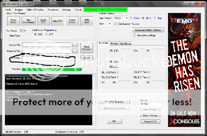

    6.Open J Runner (Run As Admin On Vista Or 7)

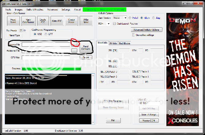

    7.Open You NAND
    7.The NAND Is The Flashdmp.bin File On The USB
    8.Windows Will Pop Up Asking What Is Your Xbox Xenon,Falcon,etc... Click Which One You Have
    9.Add A Dash
    *Click On Add Dash
    *Window Will Pop Up And Scroll Down And Click The Dash 16.197 or 16.202 And Press Add Dash
    10.Right Top Click The Console Your Updating JTAG,RGH,RGH2,etc...
    11.Add The CPU Key
    Once It Load Click On Create Image Box
    12.Once It Saids Image ready In The Black Box - You Can Close J Runner
