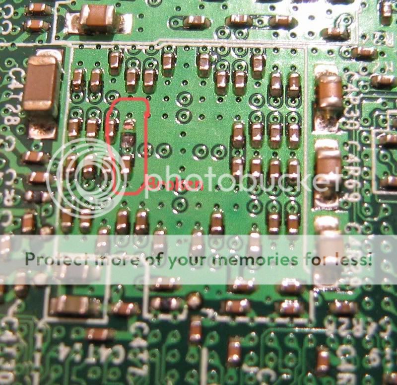

    This morning I got an Xbox 360 to fix that had 0031 and I remember seeing a member just a day or 2 ago with the same problem, I done a reflow because it's normally RAM or Southbridge cold solder joints.
    ...after I reflowed and removed the x-clams I then thought about the topic I seen the other day and it said it could be a dvd cab;e problem so thought I'd have a look since it was RRoD as soon as it was on, it didn't try to boot (before the reflow) and BOOM HEADSHOT the cable was in the wrong way round by the previous owner!!
    ......so I put her back together and it tried to boot until 0103!!!!!
    Shorted resister under the GPU:
    Moral of this story is to check the simple things before you try the more tricky because it could save you a pain in the neck.
    Off to try fix the 0103 error now :(
