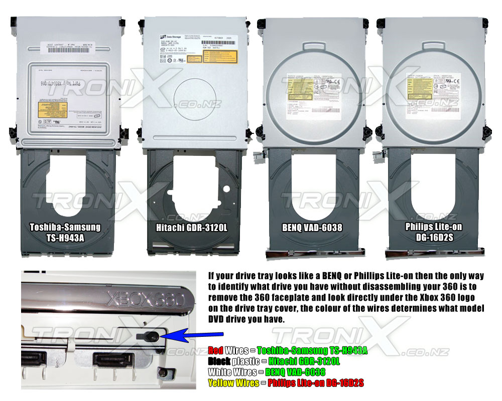

    if you plan on swapping out the DVD Drives, make sure you get the right replacement, some have a Toshiba/Samsung other's have a Phillips Lite-on and others have HItachi
    here's some visual aid to help figure out what one is which.
