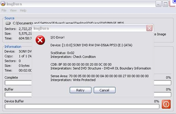

i have a laptop gateway model P-6872h with optical drive Optiarc DVD RW AD-7563A (ATA) firmware WX05, the problem is that every time i try to burn the game, using the programs imgburn,clone cd or dvd decrypter(have the latest versions ) of course i use the .dvd file, and checked with abgx360 and the file its ok, i get the I/O error between 50% to 80%, im using the memorex DVD+R DL 8X 8.5 GB made in India,i already tryed to burn it at 2x ,2.4x ,8x and still get the same error, i dont really want to buy verbatim cause i still have 3 50 pks of memorex, please some help, even i checked lots of tutorials and none worked it , thanks
you need a ihas drive flashed with LT Max xdg3 games will not burn with standard drives unless u truncate them 5000 post
