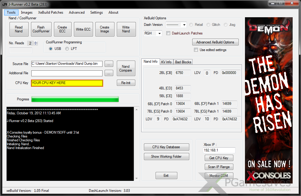

    4. To verify the key, open J-Runner and select your NAND dump using the "..." button to the right of the "Source File" box.
    5. Combine or enter your CPU key and press "Re-Init."
    6. J-Runner will tell you if your key is correct or not. If it isn't keep trying.

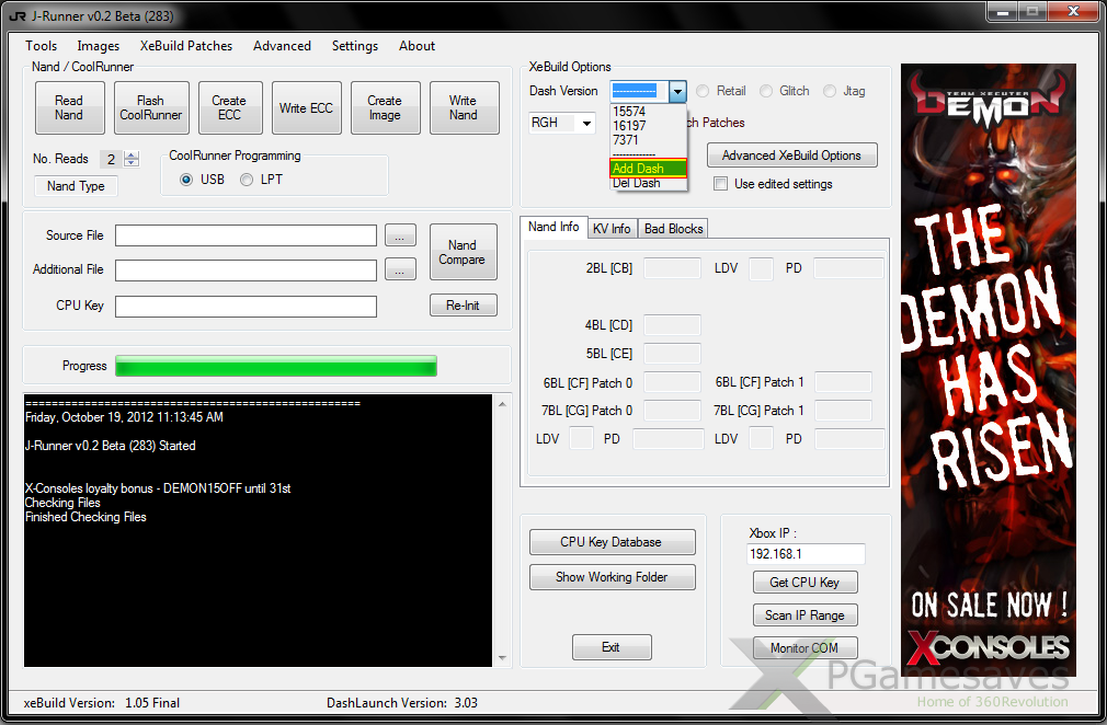

    2. Click on the Dash Version drop down box.
    3. Click "Add Dash."

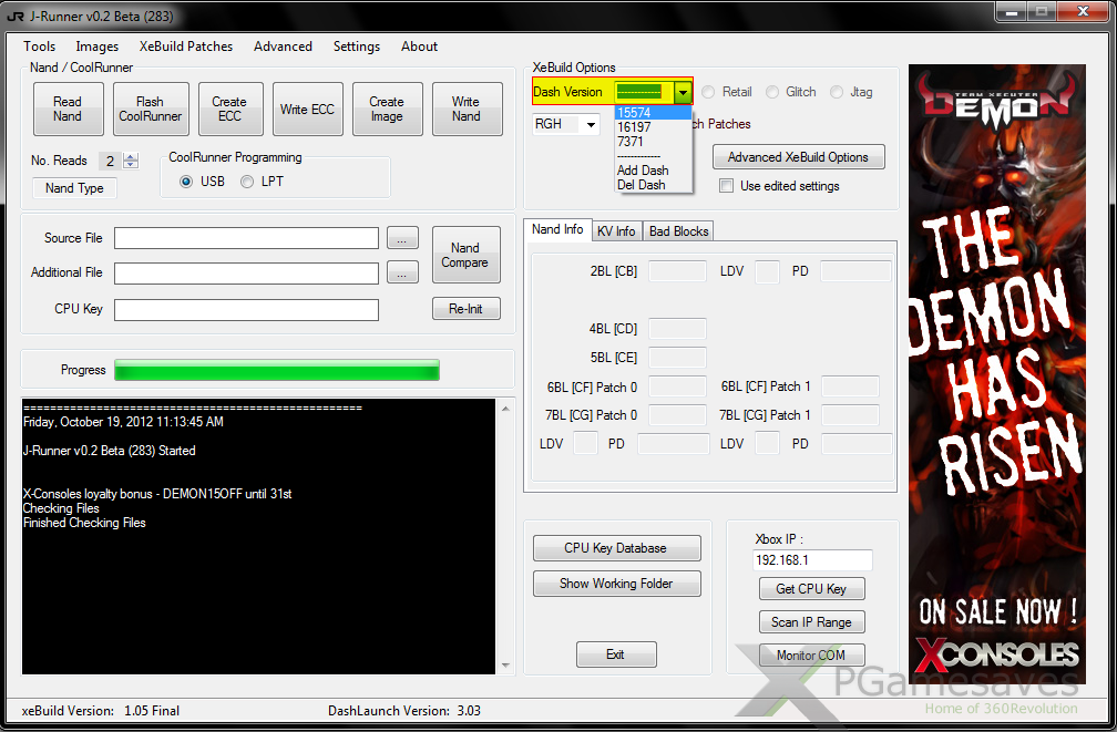

    4. Double click the check box for whatever dash kernel you want. (16202 is the newest as of writing.) Press "Add Dashes."
    5. Let J-Runner download all files needed. Keep an eye on the black box. It will say "Finished Checking Files" when it's done.
    6. Open your NAND dump in the " Source File" using the "..." button to select your NAND dump.
    7. Copy and paste your CPU key into the CPU key box.

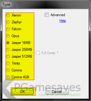

    8. Select your console type. Press OK.
    9. Select the dash you wish to use. (16202 is the newest as of writing)

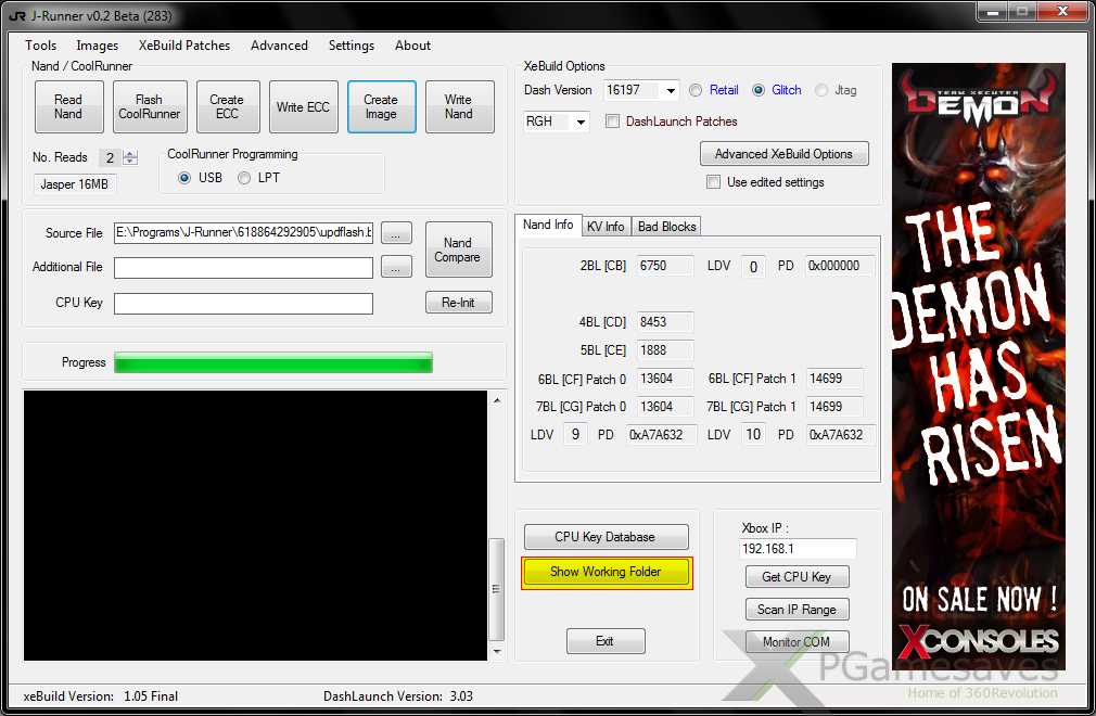

    10. Hack type. (JTAG or RGH) If you have a RGH console, select if it is a RGH or RGH 2 console. All slims are RGH 1. If you have a JTAG, select rather or not you have the AUD_Clamp wiring method by using the check box.
    11. Click "Create Image."
    12. When it's done, click "show working folder." That will bring up the folder with your updflash.bin file.

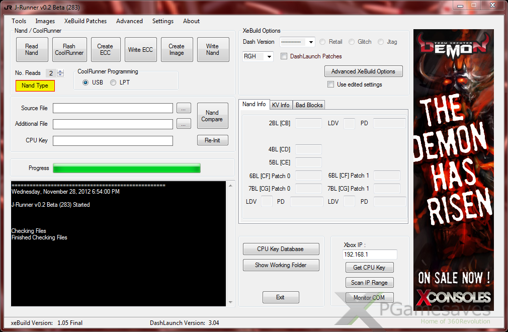

    50
    Nice tutorial man but where do i select myt console type? i can't seem to find it
  16. BMTHstanton1990
    BMTHstanton1990 RGH/JTAG God
    Mar 28, 2011
    843
    264
    United States
    It's the grey box that says NAND Type. When you load your image, it don't say NAND Type anymore. It's the grey box under "No. Reads."
