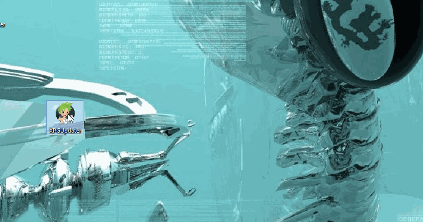

    This is not a standalone GUI, it uses xebuild to patch and update your console. All the options available in this GUI can be done via command line, this was made to be very user friendly and easy to understand.
    There are two versions included in this release.
    v0.3 lite: A basic updater, no options besides Forced IP.
    v0.3 r2: Has almost all options from the xeBuild update and client modes.
    Thanks to the xeBuild team for giving us this great easy way to update your console and for updserv, JPizzle @ RMS for the original tutorial and begallegal for the XPG tutorial and original .bat idea ;) Huge thanks also to the Dashlaunch team.
    You must be running updsvr_standalone_v1 on your console for this GUI and xebuild to connect and perform maintenance on your console.
    Setting up updsvr
    1. Extract the updsvr_standalone_v1.zip to a folder and transfer the default.xex to the root of a usb drive.
    2. Plug the usb drive into your console and power it up. You should now see updsvr on your console.
    If you are experiencing connectivity issues with updsvr standalone v1 please try running the built in updserv from within Dashlaunch or at last option try updsvr standalone v3.
    Easy Update
    1. Open the XPGUpdater.exe and click the Update Now! button.
    Yes it is really that simple to update your console.
    Once the console powers down after flashing remove the usb drive and it will now load into your dashboard set within your launch.ini
    If you have any issues connecting to your console try using the Force IP option.
