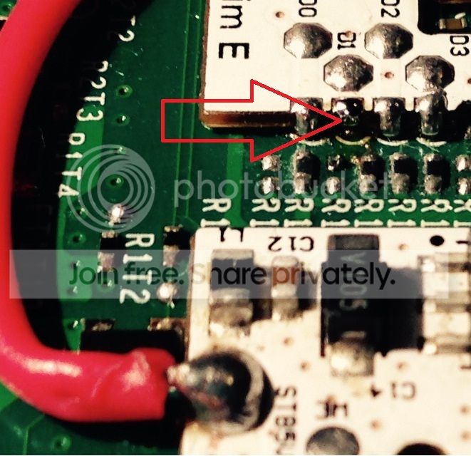

    Hi
    I have a 2010 Trinity dual nand slim with DemoN and CR3 pro.
    Problem:
    Console boots stock dash with no problems at all. When i boot RGH side im getting no power lights no boot nothing at all. (only sound board works)
    I can leave the console for a hour unpluged come back and it will boot. If i turn the console off and re-boot sometimes it will have loud fan and not boot. So remove the power cable and replug back in to find no power again at all till i leave it standing again.
    Install is sweet no problems there.
    I can read the nand in jrunner and flash a new image but i still have the problem.
    Lost on what to do next ? Any info would be cool please before i smash it up. :)

    Try re-flashing your nand with the latest dash. If that fails it sounds like faulty wiring, check your solder points.

    Problem sorted it was bad point on DemoN that needed re-solder

    i'm guessing it was the RB point or the green wire on install diagram??

    D1 had a bad connection

    yup, that will do it. After a install I always retouch up the points a 2nd time with some extra flux.
