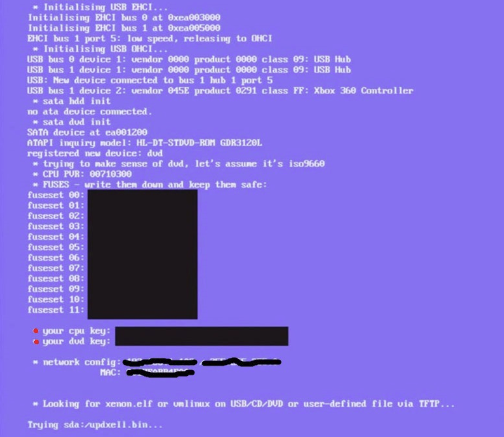

    How to get your consoles CPU key
    1. Make sure you jtag/rgh is fully off
    2. Press the Eject button to power it on
    3. Xell should boot up and your CPU key should be displayed
    • Should look something like this:
    Note: I suggest copying both your CPU and DVD Key for future references.
