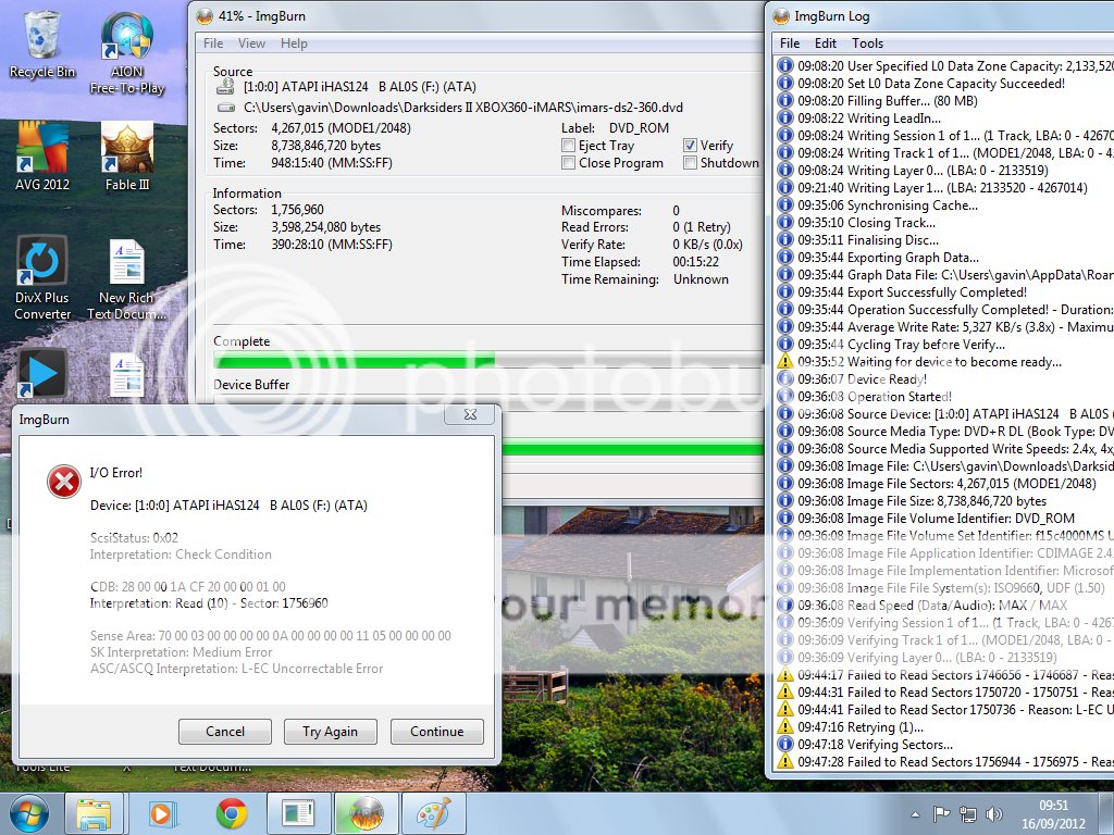

    HI all hope sum1 can help me i am having problem burning disks im i have ihas burner with apparently correct firmware im using verbatim high quality disks the disks seem to burn correctl i have had only 1 sucsesfull burn on 1 game out of 5 tries wich was sleeping dogs the 2 games failed 2 tries each same error were darksiders2 and dark souls both ran through abgx on auto fi level 3 and am using latest image burn pls see scan of error pls help cant afford to keep messing up disks ty for any help pls see scan of error

    im not sure about this but is it possible a problem with my ihas drive reading the disk to verifiy as the 1 game that did burn ok i think i may of skipped the verifiy stage and the burn completed correctly and the disk passes all abgx and works perfect?? have only 3 disks left out of 10 and 1 game burned any ihelp will be greatly apreciated.

    DO NOT VERIFY! Any burned games you WILL get an ERROR!

    i was having same trouble go to imageburn settings reset settings to default then select layer break caculate optimal burn at 4x with opc ticked now since then ive burnt 10 disks and everyone has burned and verified it worked for me so worth a try
    and verify at least then you will know that youre burns are good trust me i tried every thing even reflashing ihas burner and reflashing xbox but now everything burns fine

    Dont use abgx to fix it .On imgburn go on tool, settings then write and on layer break tick user specified and enter this 1913760 now press ok .Burn at 2.4 speed . :blind:
