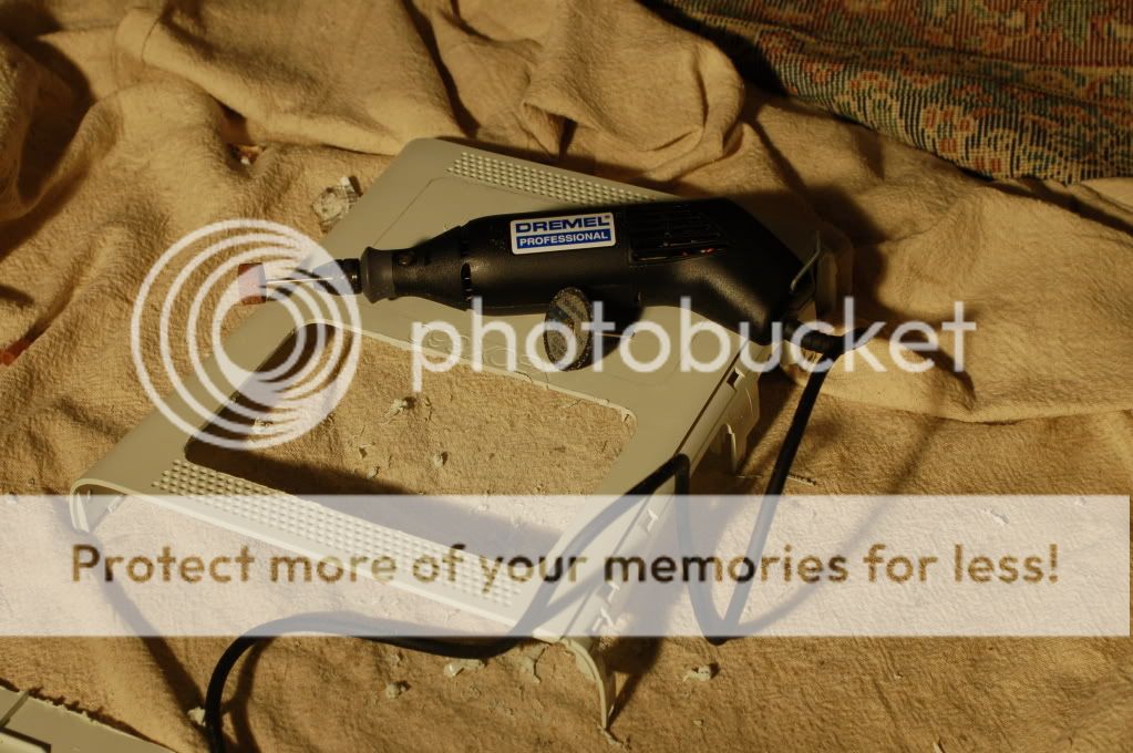

    Step 4.5: Cutting
    Use the dremel, preferably with a plastic cutting bit. Cut the straight parts and skip over the rounded edges like so,
    remember ignore the rounded edges and skip over them like so
    Resized to 59% (was 1023 x 680) - Click image to enlarge[​IMG]
    When you pop out this shape, you are left with little triangles in each corner. Use a sanding bit to sand in and create that perfect rounded corner
    (sanding part picturized)
    Resized to 89% (was 680 x 1023) - Click image to enlarge[​IMG]

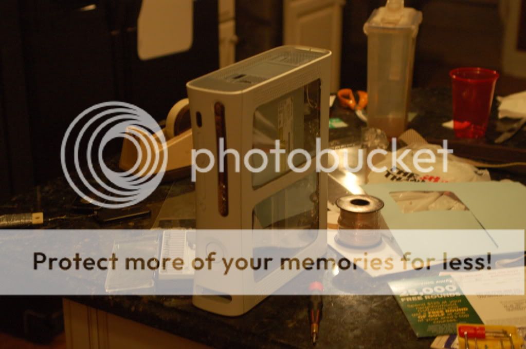

    Step 5: Plexi Glass/Plastic/Acryllic laying.
    This part is hard. Flip over the xbox 360 case and try to cut off the screw hole receivers so you can get a flat rectangular shape in order to be able to lay in the PG/P/A. This part can be skipped but eh, doesnt look so good. Then you can cut of the corners in order to fit it.
    Now lay the tape in every corner and one piece in the middle piece of plastic, its the part with the xbox 360 on it and then lay your PG/P/A on top and push in every spot with the tape.
    Step 6: Put it back together.

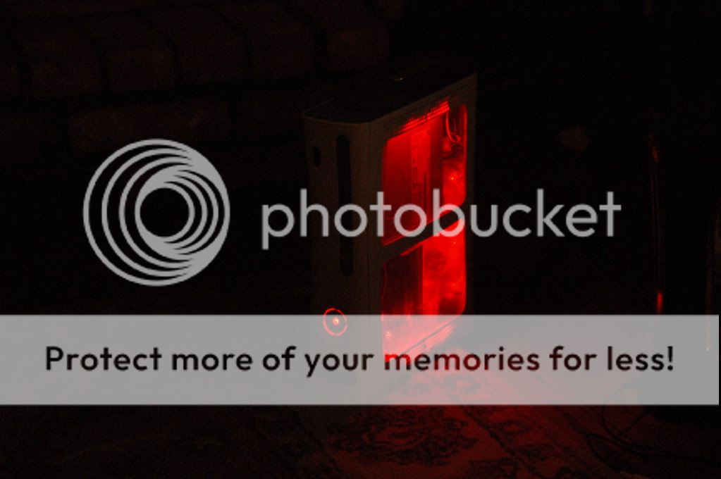

    Step 7: Now plug it in!
    Plug it in and enjoy, the smart led storm comes with a remote to change the colors!
    Rewind the process of taking the xbox apart, and put everything back together!
