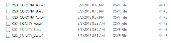

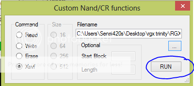

    With the new DGX to RGX feature to allow you to use your DGX as a RGH chip you will need to flash your DGX with the correct XSVF file for your motherboard type. AS of right now there is only Trinity and Corona XSVF files available from TX.
    But as of today J-runner has not been updated to include these new XSFV for upgrading your DGX 1.0s or 1.1s. But there is a way to do it.
    Connect your DGX to your NANDX or J-Programmer

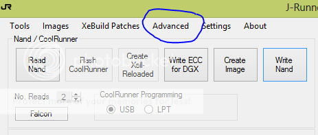

    Open up J-Runner and click on ADVANCED then CUSTOM NAND/CR FUNCTIONS

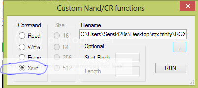

    In the new window that opens select XSVF in command section

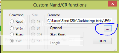

    then select the browse button and find the proper XSVF file you will use for your motherboard type
    I am doing a trinity so...
    Then hit RUN
    This will flash/write the XSFV files to your DGX to convert it to a RGX

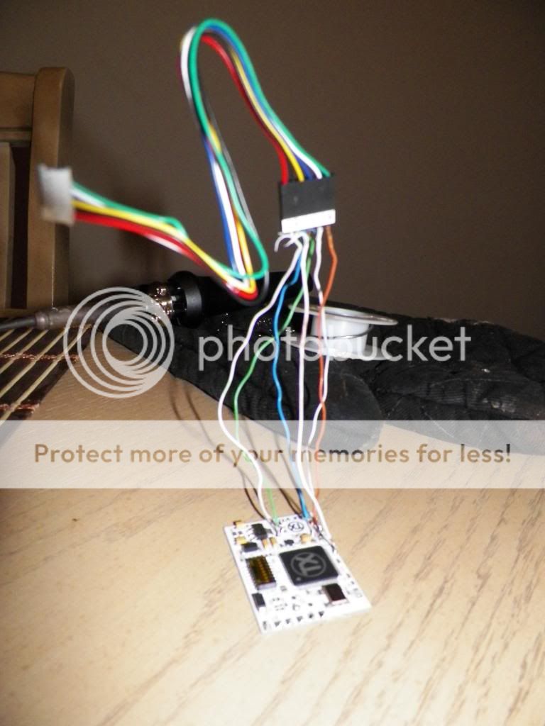

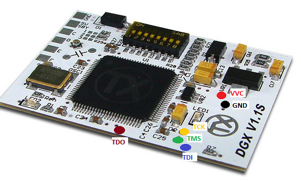

    If you have a DGX1.1s you will need to solder your update cable to the solder pads.
    I didn't want to cut my update cable so i solder wires to mine and then slide them into the pin header plug.
