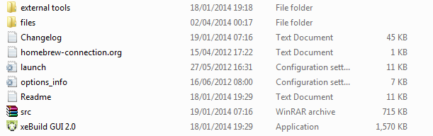

    Now you’re back on your pc extract the 16747 files using win rar.
    You should now have a folder what looks like this.

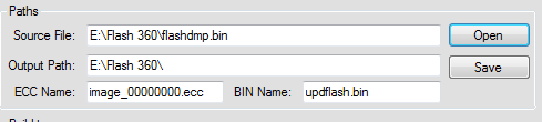

    Now click SOURCE FILE and open your nand img from your USB.
    So it looks like this.
    Now select where to save your output image I always use my desktop for this.

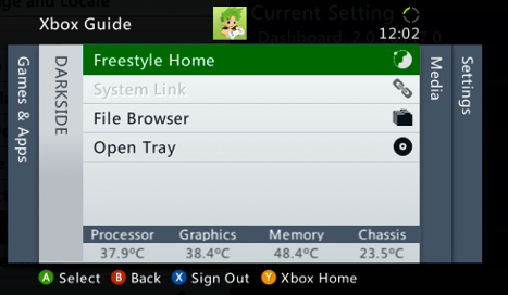

    Once you are now booted go into console settings and check your dash.
    BOOM you are now on 2.0.16747.0
