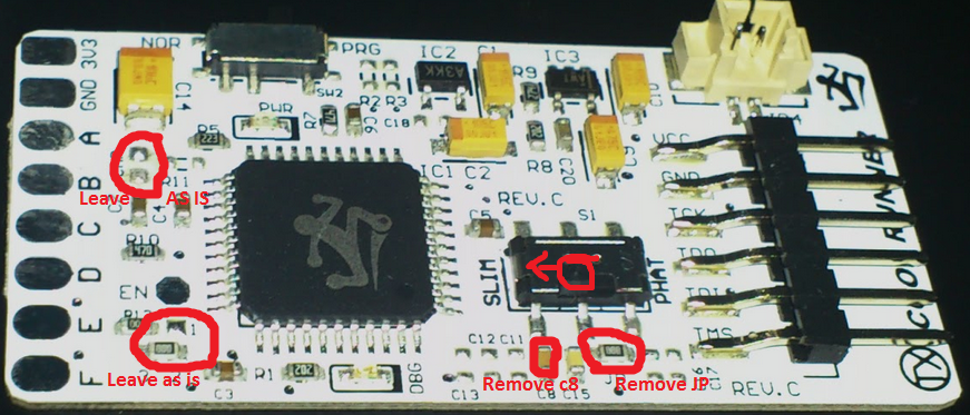

So far Ive done this on about 6 or 7 falcon rgh2s Using these settings I hear alot how horrible boot times are for falcon rgh2 but this can be over come with these settings Coolrunner rev cFalcon RGH2 Timing file JP open3/2 closed .. bridgedCap Open use shorter Blue wire for Phats cpurst routed over fan shroud Remove c8 resistorswitch set to slim 5 to 30 second bootimes almost every time every once in a while there will be a 60 second boot But in my opinion and from observation this always works and always works well
Where the hell were you this morning lol, I did 2 of these! I used: Slim switch CR3 Lite LK 1 bridged LK2 bridged LK 3 open Lk 4 open S4 all switched off S2 4 & 8 on "blue wire" top of the board. Timing file Falcon, A on another worked good too. Times aren't bad but I would have did this method instead, thanks for the info.
Ahh sorry bro Yeah I like to save my CR3 Lites for those Pesky RGH2 jaspers try this next time Make sure to remove C8 and switch to slim you will fall in love with this method

Thanks for this info!! Usual glitch time was about 2mins to 5mins but after doing this I'm getting the times you stated
