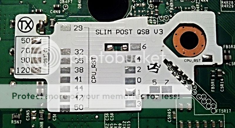

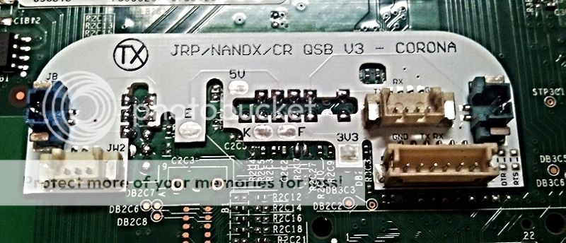

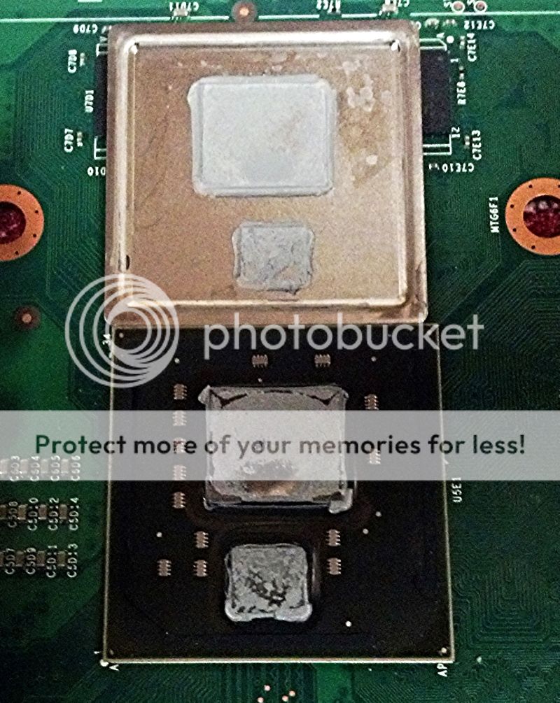

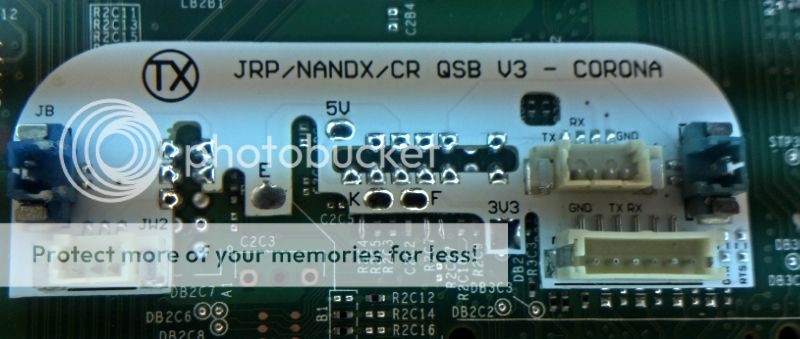

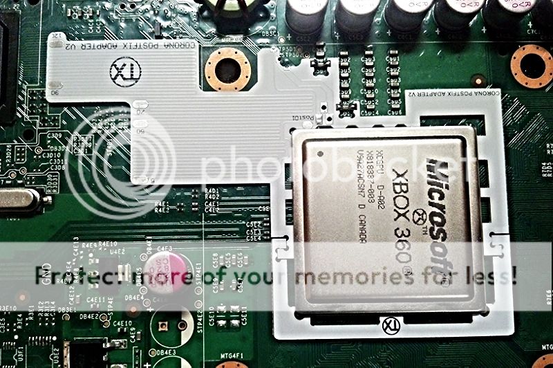

    Well i'm pimping out a 360e with everyting that TX offers for a Corona and a case mod, in the process i decided to changed the crappy thermal compound between the die/ihs & ihs/heatsink.
    In the pic below you can see a spot on both dies that had very little if any thermal compound, glad i never booted it because i just bought it today.
    Supplies Used:
    TX: Corona Postfix v2, Corona 4gb R/W Kit, Corona v3 QSB, Slim Proto v1, Slim Post QSB v2, Ipex Cpu Reset Cable.
    Thermal Compound Used: IC 24 Carat
    Heatsinks Used: http://stores.ebay.com/DIY-FancyLights/Heatsinks-/_i.html?_fsub=6492276015&_sid=1184035545&_trksid=p4634.c0.m322
    SD Card Reader Used: Sandisk MobileMate SD+
    Soldering Station: Aoyue 936 with 900M-T-I 0.4mm Tip
    Solder Used: Kester SN63PB37 #66/44 Rosin Core 0.15"
    Flux Used: Kingbo RMA-218

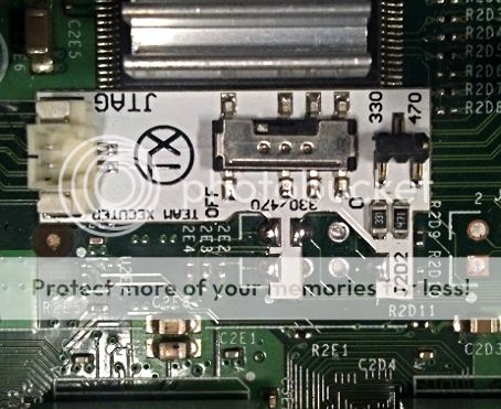

    Also had a friend design me a multicap addon for the slim, kind of like the multicap addon for CR because I got tired of soldering diff caps to test boot speed.
    Credit to 3D0kassiah of Acidmods for the design..

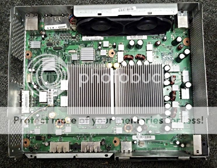

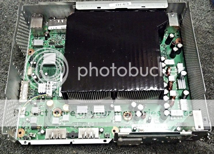

    Got my $10 batch of heatsinks with 3m thermal tape for ram, southbridge, nand, voltage regs in today, I know Its overkill but i had a $10 ebay gift card so i said why not.
    I have this ordered for the 2 ram chips on the left side under the heatsink in the pic above.
    Fujipoly Ultra Extreme System Builder Thermal Pad - Mosfet Block - 100mm x 15mm x 1.5mm - Thermal Conductivity - 17 w/mk
    http://www.frozencpu.com/products/17502/thr-186/Fujipoly_Ultra_Extreme_System_Builder_Thermal_Pad_-_Mosfet_Block_-_100_x_15_x_15_-_Thermal_Conductivity_170_WmK.html?id=T8mARZek&mv_pc=654
    17 w/mk is better than most thermal compounds, IC 24 Carat is only 4.5 w/mk & Arctic Silver 5 is 8.5 w/mk. I'm tempted to try the Fujipoly on Cpu/Gpu.
    I know most of the stuff in this reply is overkill but i had the spare cash and wanted to test to see how much it helps temps if any..
    I doubt I'll be able to sell this RGH because I have $180 in the brand new console & $130 in RGH & Cooling supplies, lol. But I don't mind keeping it for myself..
  8. gameroms
    gameroms XPG
    Nov 3, 2013
    2,461
    437
    US
    UPDATE: Got it all wired up and booting Xexmenu.
    Xexmenu temps are 44c CPU, 42c GPU, 40c RAM, 38c MB after 2hrs of Ghost
    Cooling Mods: IHS removed from cpu/gpu, IC Diamond 24c, Heatsinks on all chips, Fujipoly 17 w/mk thermal pads on the ram under heatsink

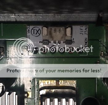

    XENON JTAG PRE-NXE
    This Is my personal offline jtag that has 320gb hdd and 2 2-tb external usb hdd's. Hdd's include complete xbla collection, complete xbla & retail DLC set, also includes about 90 360 games plus emus & roms.
    This Is my favorite jtag and I'm dedicated into investing in cooling mods on it to keep it alive.
    *The Weird Thing Is That This Xenon Has The Glue On CPU/GPU, I'm Guessing It Was A RROD Repair Or Replacement Since The Xenon's Didn't Come With The Glue When Released*

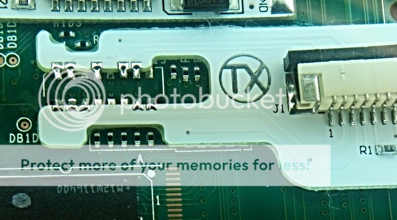

    STARTING A v5 CORONA DUAL NAND PROJECT TODAY!!
    IT WILL BE VERY SIMILAR TO MY v6 ABOVE BUT WITH 250GB HDD..
    UPDATE: It looks like my 14yr old son that I taught to solder decided to make this his 1st RGH build while I was out of town. Here are some pics of his install, I still have to show him how to cut a window in the case, cut a window in the dvd drive and install leds and after all that it will find its way to the marketplace if he doesnt try to keep & if he does try to keep i'll have to sell his jasper rjtag.
    THANKS TO THE GUYS OVER ON THE TX FORUMS FOR BEING PATIENT WITH HIM & HELPING HIM ALONG THE WAY..

    Corona v5 With X360 Stone v1.1 Install Pics Coming Soon..
    This Is my first time installing a X360 Stone v1.1 (DGX Stone) and so far I'm not very happy with the solder pad layout on the chip because it makes the C1 & C2 Wires cross each other and I personally don't like crossing wires unless there is no other option because back in the PS2 days it caused major interference.
    Edit: The X360 Stone is crap, It booted to xell one time & then the chip never powered up again.
