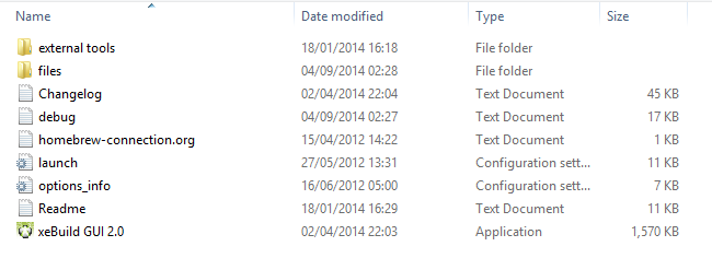

    Once you're back onto your PC-Laptop extract the RAR file you downloaded above and you will should have all the files listed in the image below.

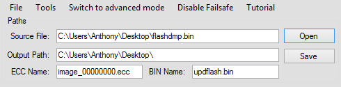

    Now open xeBuild GUI.
    And click SOURCE FILE and locate the backed up nand img you just made on the USB.
    Once you have opened your nand img it should look like this.

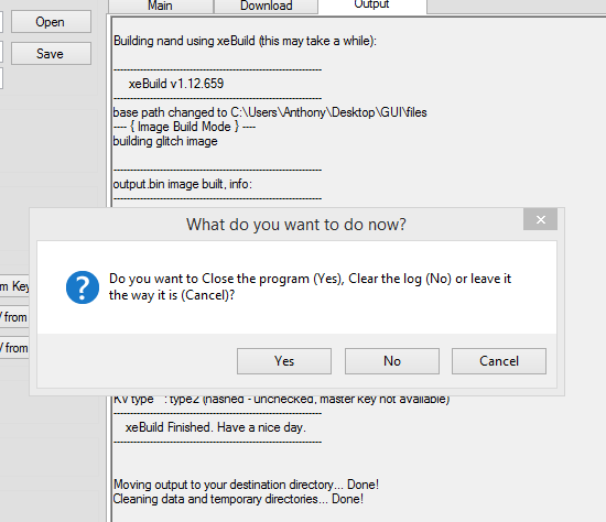

    Now click generate hacked image.
    Once completed you will this in xebuild if the new nand has been made successfully.
    Click YES to exit.

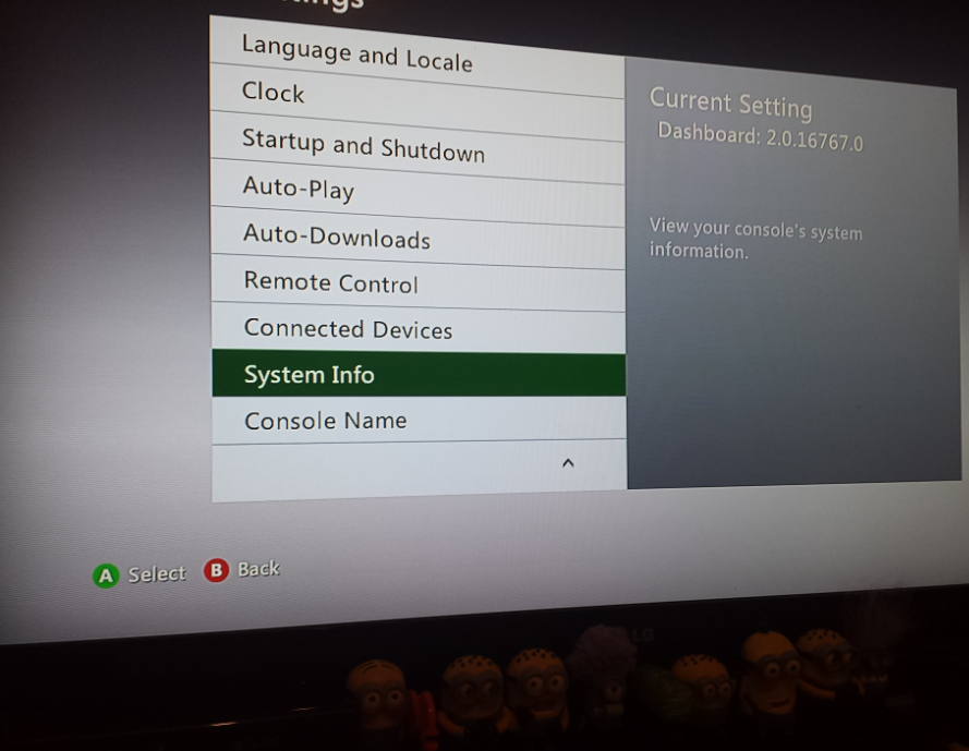

    Once the console has booted go into settings and check your dash.
    BOOM you are now on the latest dashboard 2.0.16767
