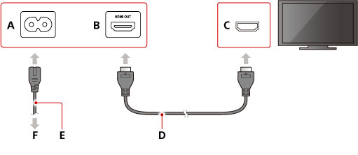

    3) Check parts A, E, and F for any conspicuous damage or anomalies
    • You can try using another compatible AC cord (like a power cord from a PS3) to see if that resolves the issue
    A) AC IN connector
    B )HDMI OUT port
    C )HDMI input port
    D )HDMI cable
    E )AC power cord
    F )To an electric outlet
