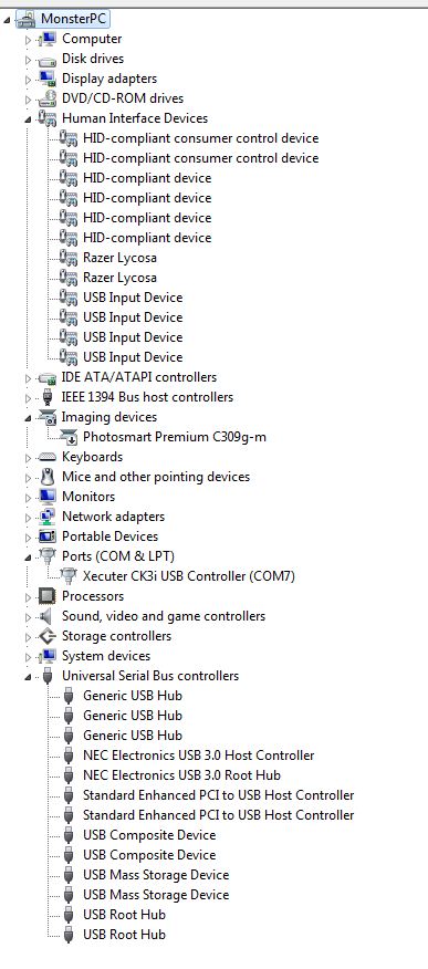

    Well I don't have any marks in the device manager.... here's a screenshot!

    The ck3i part is there at least. I had to install two sets of drivers for the usbpro 2. Turning it on might prompt you for the second install. Also your update and aux switches on the side need to both be in the left position

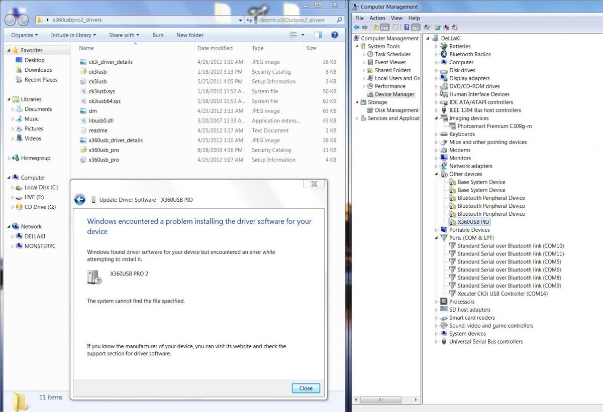

    Ok so im at another computer now my laptop (32bit) and this is what happend....

    oh I thought only after that firmware I would need a probe..... I read somewere that the stock pre june2009 didnt need it with the pro2...
    and what about the error for the drivers???
  10. pl
    plamb Newbie
    Nov 1, 2012
    Athens, GR
    ok installed the pro 2 drivers... just had to redownload them!
