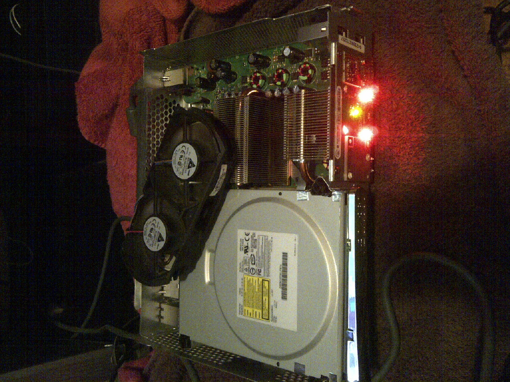

    ive got the 3 RROD. ive re applied thermal paste and all that. im just not sure how long to have the system overheating for. i have the fan plugged in cooling the CPU..but HOW LONG? 1 hour? 2 hours????
    i have a throwback '07 elite...modded....i dont want to get rid of it. someone help me out here!
    please and thank you! :D

    thats only temporary fix and might not last. But leave it for 10-20 mins .

    10/20min? really? lol...ive had it goin for an hour so far. is there a more efficient way to do it? an at home kinda way?

    when the 3 lights flash wait till they go to 2 then leave to cool down and seitch on also are you useing artic silver thermal paste if not use that

    its been goin over an hour, still 3 flashing red. im using a thermal paste, not that specific one. i live in toronto, and apparently all these electronic spots have no idea what im talking about when i ask for it. so thermal paste in general isnt easy to come by....unfortunately

    k...im all out of options here. do u think the fact that im not using arctic 5 thermal compound could be the issue? im using a no name brand compound that is white and has the viscosity of white out. im thinking that arctic 5 may be a bit thicker and work. whats ur suggestion?
    i found a spot that does sell the arctic 5, but only in the big tube....so i basically will get it if it works...but dont really wanna waste my $$$$ and gas if u dont think it makes a difference.
    any help is always appreciated :)

    It should not take hours to overheat if thats the way your trying to fix it
    takes about 10 min for 3 lights to turn to 2
    Feel your heatsinks are they getting hot if not there's another problem :|

    Firstly whats the secondary error of the console? You maybe trying to fix something that frankly isnt fixable...

    there could be so many things that could be wrong screw tightness screws leveled out correctly paste used etc etc if youve bought a proper clamping kit and correct paste itll probably need a complete reflow but then youve gotta put all the heatsinks back on and hope for the best this is why i avoid red ringers like the ex missus too much hassle .
