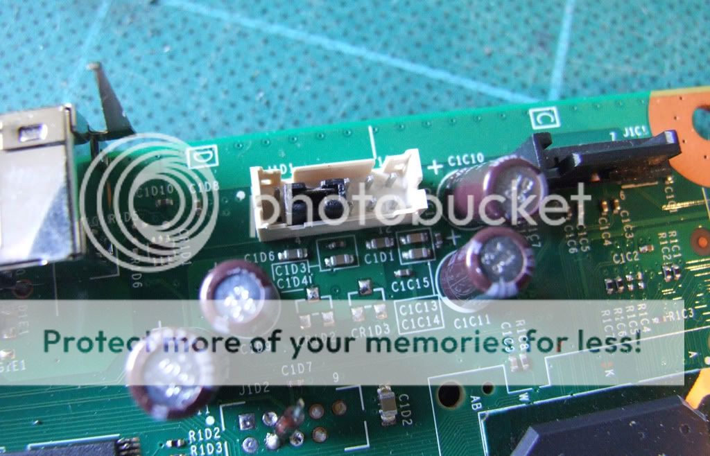

    You can fix the bricked drive once you have the DVD key or just remove it entirely and jumper the dvd power cable pins like this to keep the center light from flashing
    NOTE: if this is all due to a pesky E64 error that is because your drive does not have the correct firmware flashed to it (or is wrong model drive) ,,you can simply flash the correct FW and though without the DVD key correct you will only be able to play cd's and DVD's ,,(not games) but the console will then boot without error
