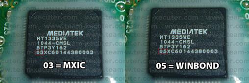

The template is not always reliable ADDZ. as each chip can be just a little bit away from the pins. You're better off zooming in with a high quality camera or a microscope and taking a picture of the pins under the eproxy and then count 5 from the right from the top and then 4 pins down the side of the right of the chip, then just mark yourself a point to drill. Use 0.8,mm drill bits as they won't make a hole in the chip too big. Depending on the drive revision, whether it's DG-16D4S or DG-16D5S you will need extra hardware as listed above. DG-16D4S: Sputnik Unlock Probe if MXIC chip CK3 Pro or a USB Pro and some brains. Alternatively as listed above, you can always buy an unlocked PCB which will probably be cheaper that messing up a Kamikazi or Sputnuk unlock. They are not easy tasks for beginners. If it's a DG-16D5S There is no way for simple here, you will need to RGH the console to retrieve the DVD key and then get a hold of an unlocked PCB. Some Trinity consoles DID have the DG-16D5S, so make sure you take a look at the sticker on the DVD drive and tell us exactly what it is.
