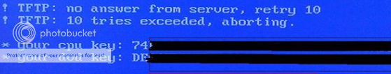

    3. Your JTAG/RGH should boot up and show your CPU Key (Type or Write it down)

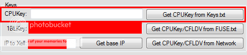

    5. Open xeBuild GUI and in Paths set the source file as the Flashdmp.bin
    6. Set the Output Path to wherever you want the New dmp to be saved
    7. Then Enter your CPUKey into the CPUKeys area,
    8. Set the Kernel Version to whichever one you want I recommend 2.0.15574.0 (Latest Kernel)
