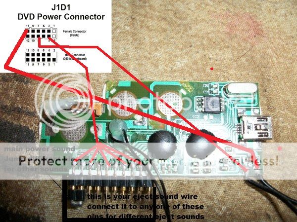

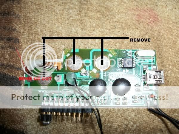

This is my first J-Tag tutorial! Hope you guys like! Here is a short Video of FAT falcon Xbox360 Booting and Ejecting using theXbox360 slim Sounds. INFO: Works on Any Xbox360 Modded or Not...... Plays 5+ Different Sound's it can Be Voice or anything Uses .MP3 and .WMA audio Files Holds Up to 210 Seconds of Audio Easy To Upgrade The Sound Files Via USB and .EXE app make sounds Short or as long as u want up to 210 seconds total very little Soldering Required-no real skill needed. Tutorial: ----------------------------------------------------------------------------------------------- Things you will need for this mod.............. 1. Sound mod board like this: http://www.ebay.ca/itm/200s-USB-modu...item35ba7955dd 2. Mini usb Cable 3. Custom Sounds and Board Programmer App http://www.mediafire...febyx2oyynm3ogf or any sound you want. Lets get started.... 1.Prepping the Sound mod board for install First Remove all three Batteries from the Sound mod board and Bend up the Activate Switch so there is no contact with the Circuit board.. Example Pic 2.Connecting the Sound mod Board Connect everything as showed in the diagram Except only connect 1 wire to the pins to choose eject sounds. Example pic 3.Programming your Sound mod Board Plug-in your Xbox360 Power Brick Then connect your Mini USB Cable to the Sound mod Board and the other end to the pc USB Port. Install the sound loader you downloaded from me earlier and Open it and Add The Sounds you would Like. Also Change the Settings Exactly Like the Picture Below Shows. When Ready Just Click Write and if all Goes Well it will say Success... There you go your Xbox360 Should Now Be Booting/ejecting Custom sounds.... Now Just figure out where you would like the sound mod Board Placed and Clean up...... Here is an example. TIP.. PIN 1,3,5,7,9 are used For the Wire For different Sounds and the pin jumper is for boot sounds PIN 2,4,6,8,10 are Basically Just Ground's Any suggesting's would be nice to see what i can improve on. Hope this helps!
