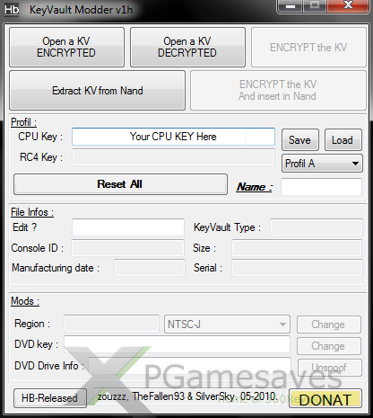

    Extracting a KV from a nand:
    Download: KV Modder.
    Step One: Open up KV Modder.
    Step Two: Enter your CPU key
    Step Three: Load your nand dump.

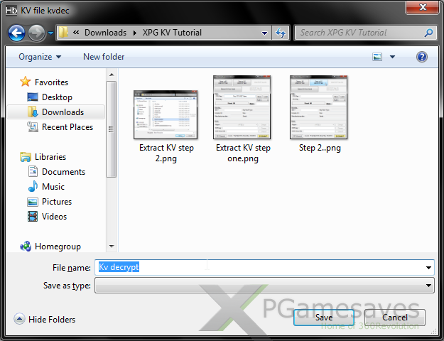

    Step Four: Select where to save your decrypted KV.
    Step Five: Select "Yes" to load up your decrypted KV you just extracted.
    Step Six: Continue on with verifying your KV.
    Verify your KV:
    Step One: Load up KV Modder
    Step Two: Click "Open a KV Decrypted"
    Step Three: Find your KV_dec.bin file and open it up.
    Step Four: Look at this box and make sure it says no Christmas lights. Now's also a good time to verify your KV type as well.

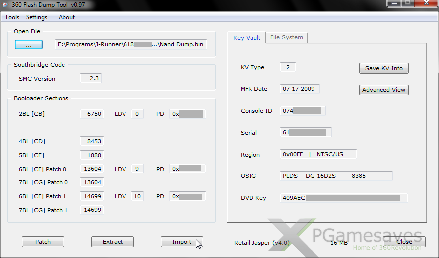

    Build a new image with the clean KV:
    Download: 360 Flash Tool.
    Step One: Load up 360 Flash Tool.
    Step Two: Click Settings on the top menu bar and enter your CPU key in the CPU key box and check the "XeX1" box as well. You can leave the numbers that are already in the XeX1 box alone, or drop your CPU key into it. I personally drop the CPU key into the XeX1 box as well as the CPU key box.
    Step Three: Click the "..." button under "Open File"
    Step Four: Select your nanddump.bin
    Step Five: Click Import.
    Step Six: Check the KV box and find your clean KV and select it. Then click "OK"
    Step Seven: Select where to save your new nand image. Save it as "updflash.bin" (No quotes).
